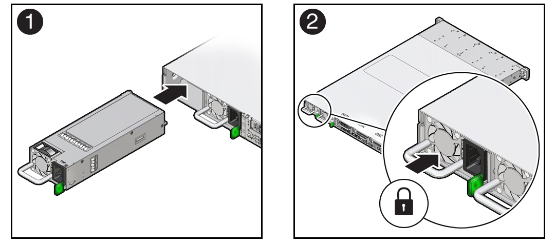

  2. Align the replacement power supply with the empty power supply slot [1].
  3. Slide the power supply into the bay until it is fully seated [2].
    You hear an audible click when the power supply fully seats.
    image:Figure showing a power supply being installed into the                             chassis.
