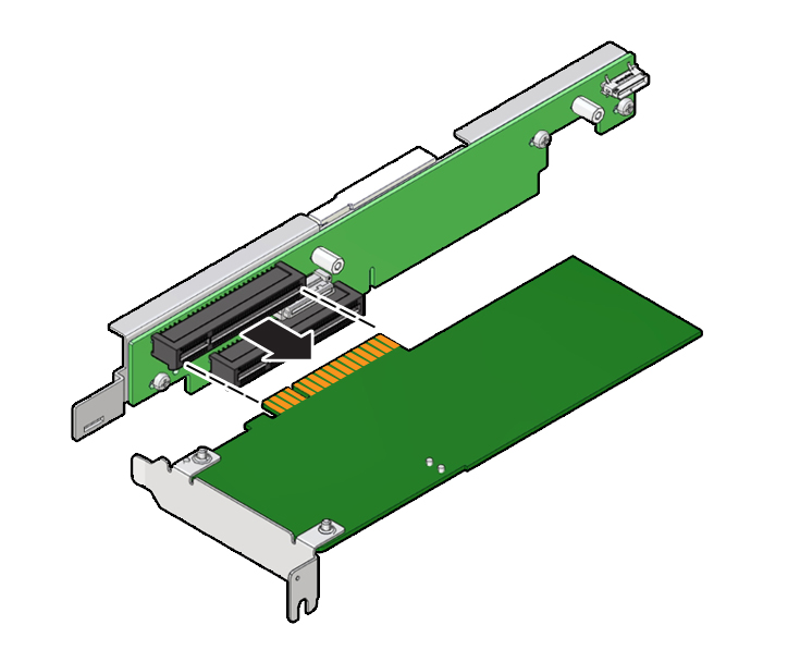

  2. Remove the PCIe card from the riser.
    1. Hold the riser in one hand and use your other hand to carefully remove the PCIe card connector from the riser.
    2. Disconnect the rear bracket attached to the PCIe card from the rear of the PCIe riser.
      image:Figure showing how to remove a PCIe card form slot                                     3.
  3. Place the PCIe card on an antistatic mat.
