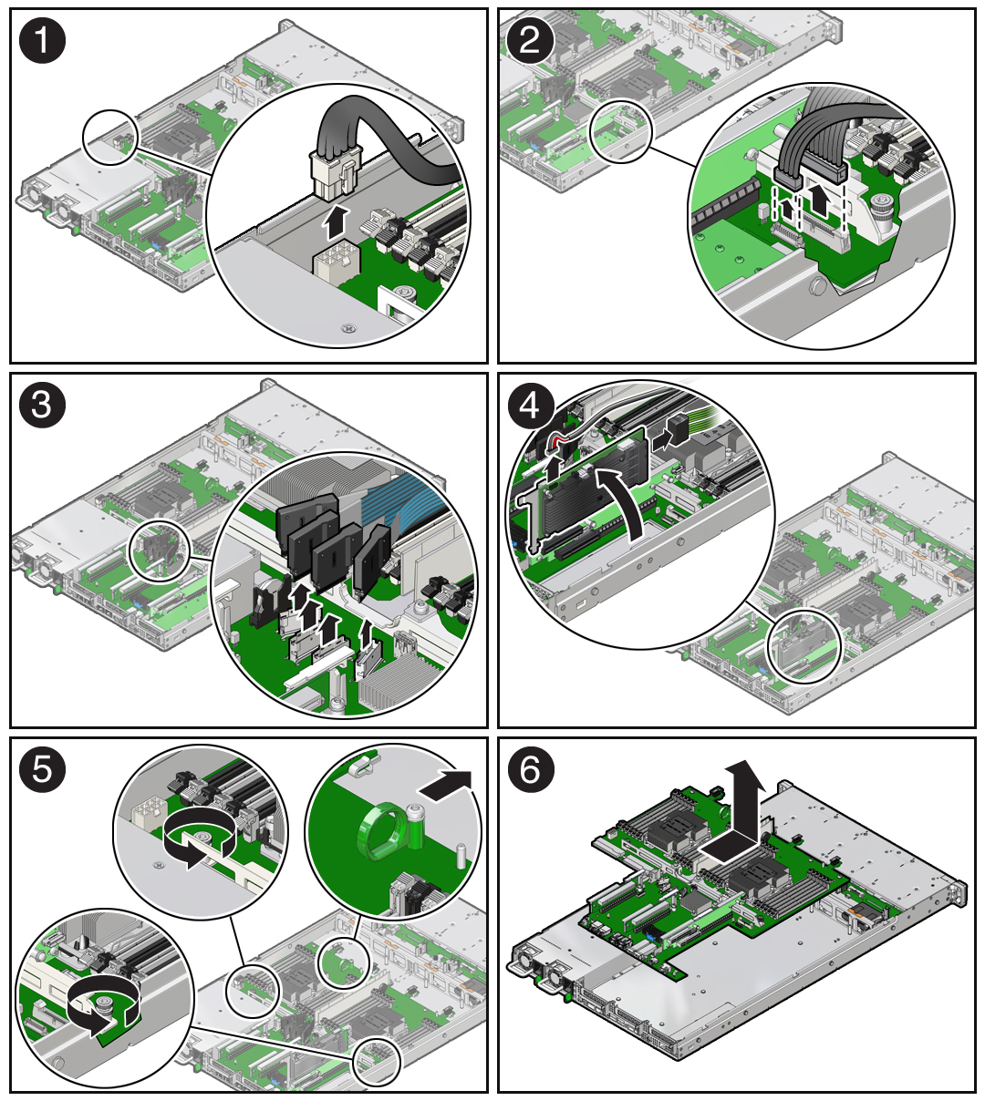

  3. Remove cables from the motherboard.
    1. Disconnect the disk backplane power cable from the motherboard by pressing in on the connector latch and then pulling out the cable connector [1].
      image:Figure showing how to remove the motherboard from the                                     server.
    2. Disconnect the disk backplane data cable by opening the ejectors and pulling out the cable connector [2].
    3. Disconnect the front indicator module (FIM) cable connector by opening the ejectors and pulling out the cable connector [2].
    4. Remove the SAS cables and the super capacitor cable that were connected to the internal HBA card, and then carefully lift them from the left-side cable trough and set them aside [4].
      See Remove the Internal HBA Cables.
  4. Remove the motherboard from the server chassis [5, 6].
    1. Using a Torx T25 screwdriver, loosen the two green captive screws that secure the motherboard bracket/handle to the server chassis.
    2. Grasp the metal bracket located just to the rear of the DIMM slots and the finger loop, and then slide the motherboard toward the front of the server and lift it slightly to disengage it from the eight mushroom-shaped standoffs located on the server chassis under the motherboard.
    3. Lift the motherboard out of the server chassis and place it on an antistatic mat and next to the replacement motherboard.

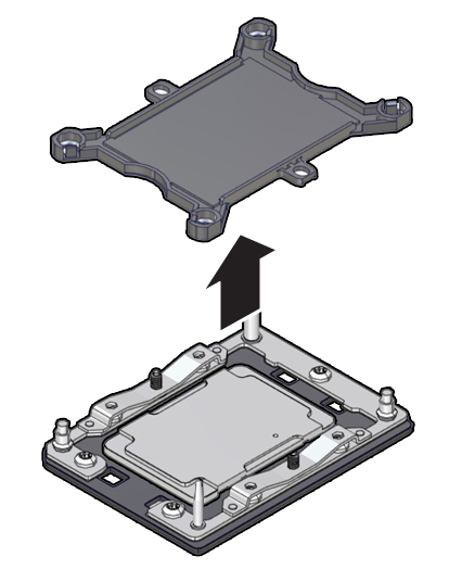

  7. Remove the processor socket covers from the replacement motherboard and install the processors.
    1. Grasp the processor socket cover finger grips (labeled REMOVE) and lift the socket cover up and off the processor socket.
      image:Figure showing how to remove the processor socket                                     cover.
    2. Install a processor into the socket from which you removed the processor socket cover.
      See Install a Processor.
    3. Repeat Step 7.a and Step 7.b to remove the second processor socket cover from the replacement motherboard and install the second processor.

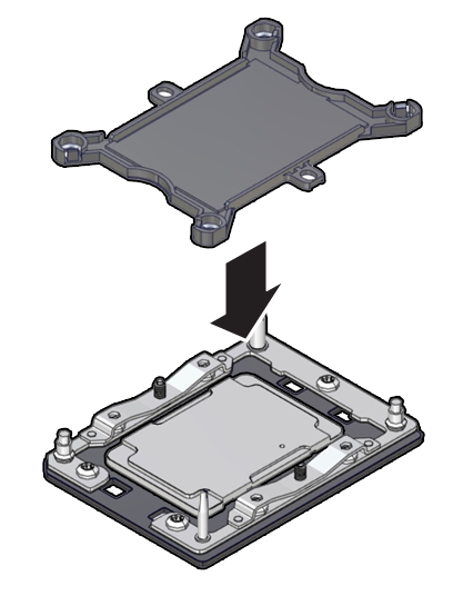

  8. Install the processor socket covers on the faulty motherboard.
    Caution
    Caution  -  The processor socket covers must be installed on the faulty motherboard; otherwise, damage might result to the processor sockets during handling and shipping.
    1. Align the processor socket cover over the processor socket alignment posts. Install the processor socket cover by firmly pressing down on all four corners (labeled INSTALL) on the socket cover.
      You will hear an audible click when the processor socket cover is securely attached to the processor socket.
      image:Figure showing how to install the processor socket                                     cover.
    2. Repeat Step 8.a to install the second processor socket cover on the faulty motherboard.

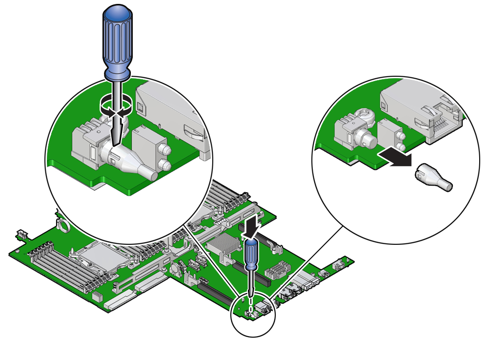

  9. Check to see if the replacement motherboard has a locate light pipe installed.
    • If it does, no action is necessary.
    • If it does not, perform the following steps.
    1. Check to see if the replacement motherboard came with a light pipe. It should be in a separate plastic bag.
      • If you find a replacement light pipe, skip to Step 9.b.
      • If you do not find a replacement light pipe, perform the following steps to remove the light pipe from the faulty motherboard.
      1. Insert a flat tool such as a screwdriver or penknife blade between the light pipe housing and the light pipe.
        Caution  -  Equipment damage. The light pipe is fragile. Handle it carefully.
        image:Picture showing the location of the light pipe, and                                             the motion to remove it.
      2. Twist the tool back and forth to release the light pipe from the housing.
      3. Pull the light pipe away from the housing.
    2. Install the light pipe on the replacement motherboard.
      1. Match the rectangular holes on the outside of the light pipe with the retaining clips on the housing.
        image:Picture showing light pipe being mounted on the                                             housing.
      2. Push the light pipe onto the housing until the clips latch in the holes.
