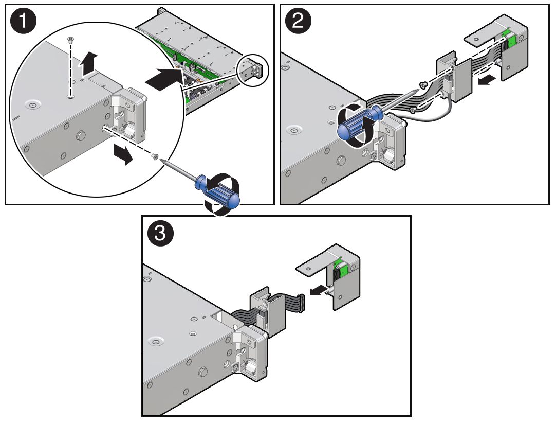

  2. Using a Philips screwdriver, remove the two screws that secure the front indicator module (FIM) assembly to the server chassis [1].
    image:Figure showing how to remove the front indicator module (FIM) from                             the server.
  3. Carefully slide the FIM assembly toward the front of the server to remove it from the chassis [2].
  4. Using a Phillips screwdriver, remove the two screws that secure the plastic temperature sensor housing to the FIM assembly, and then detach the housing from the FIM assembly [2].
    Note -  You do not need to remove the temperature sensor from the housing.
  5. Disconnect the FIM cable from the FIM assembly and set the FIM assembly aside [3].
