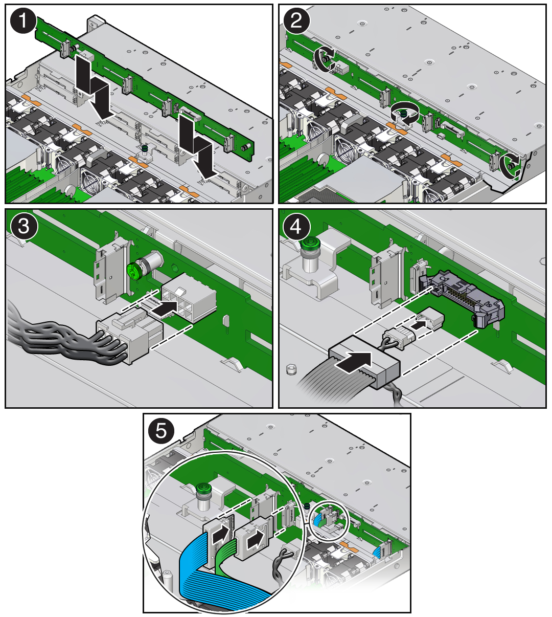

  1. Install the disk backplane into the server so that it engages the three metal hooks and also sits behind the metal tab located on the right-side chassis wall [1].
    image:Figure showing how to install the disk backplane in to the                             server.
  2. Using a Torx T15 screwdriver, tighten the three storage drive backplane captive screws clockwise until the disk backplane is secure [2].
  3. Reconnect the disk backplane power cable to the disk backplane [3].
  4. Reconnect the disk backplane data cable and temperature sensor cable to the disk backplane [4].
  5. Reconnect the SAS cables to the disk backplane [5].
