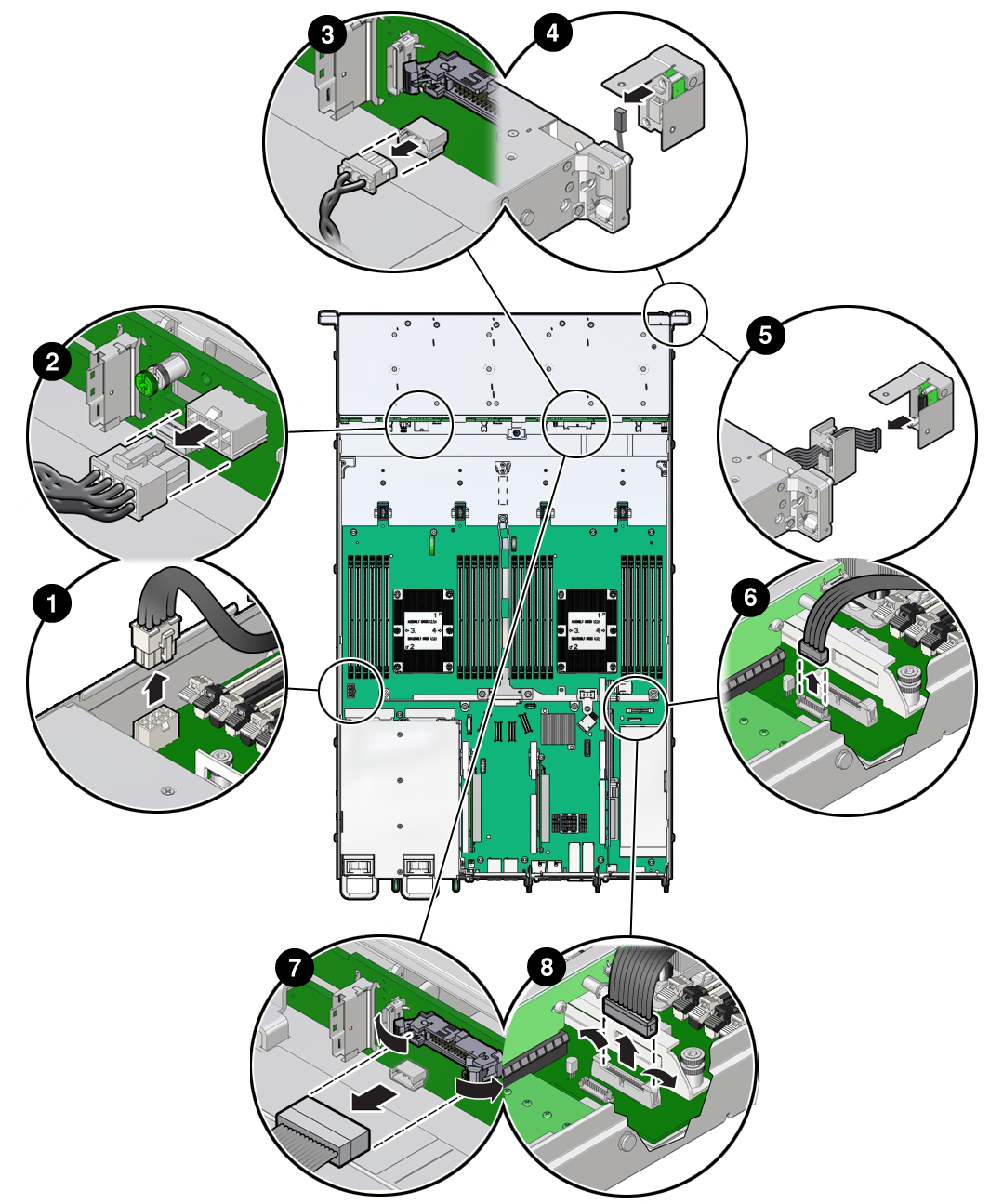

  2. Remove the disk backplane power cable.
    1. Disconnect the disk backplane power cable from the motherboard by pressing the release latch on the side of the cable connector and pulling out the connector [1].
    2. Disconnect the disk backplane power cable from the disk backplane by pressing the release latch on the side of the cable connector and pulling out the connector [2].
      image:Figure showing how to remove the power, FIM, temperature                                     sensor, and disk backplane data cables.
  3. Remove the temperature sensor cable.
    1. Remove the FIM from the server.
      See Remove the Temperature Sensor.
    2. Disconnect the temperature sensor cable from the disk backplane by pulling the cable from the connector [3].
    3. Remove the temperature sensor and cable from the FIM housing, then pull the cable and sensor through the left-front chassis sidewall [4].
  4. Remove the FIM cable.
      See Remove the Front LED Indicator Module
    2. Disconnect the FIM cable from the FIM by pulling the cable from the connector [5].
    3. Eject the FIM cable from the motherboard by opening both side latches on the connector [6].
  5. Remove the disk backplane data cable.
    1. Eject the disk backplane data cable from the disk backplane by opening both side latches on the connector [7].
    2. Eject the disk backplane data cable from the motherboard by opening both side latches on the connector [8].
