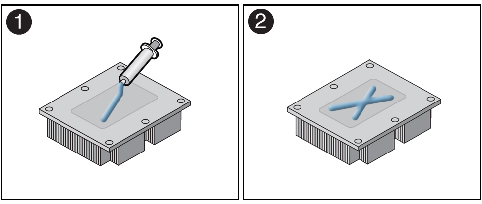

  3. Use the syringe supplied with the new or replacement processor [1] to apply 0.3 cc of thermal interface material (TIM) in an "X" pattern to the processor contact area of the heatsink [2].
    image:Figure showing thermal grease being applied to the                             heatsink.
    Note -  Do not distribute the TIM; the pressure of the heatsink will do so for you when you install the heatsink.

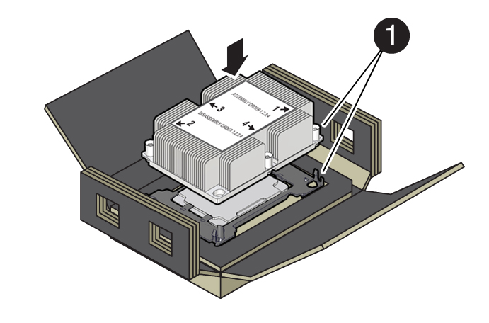

    1. Open the box that contains the new processor but do not remove it from its packaging tray.
    2. Align the pin 1 indicators between the heatsink and processor carrier in the packaging tray [1], and place the heatsink (thermal side down) onto the processor carrier until it snaps in place and lies flat.
      Note -  The processor carrier has latching posts at each corner: two that insert into heatsink holes and two that attach to the edge of the heatsink.
      image:Figure showing the heatsink being attached to                                     processor/processor carrier.

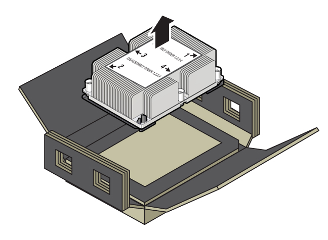

    3. Lift the processor-heatsink module out of the packaging tray.
      image:Figure showing the processor-heatsink module being lifted                                     from packaging tray.

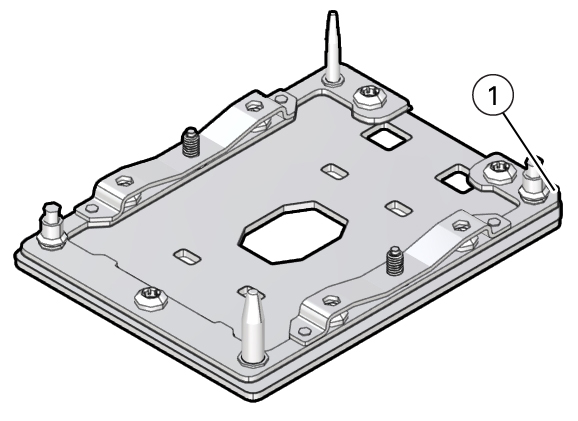

    4. Align the processor-heatsink module to the processor socket bolster plate on the motherboard, matching the pin 1 location [1].
      A small pin 1 indicator (triangle) is near the beveled corner of the socket.
      image:Figure showing the socket with callout to Pin 1.
      Callout
      Description
      1
      Pin 1 indicator

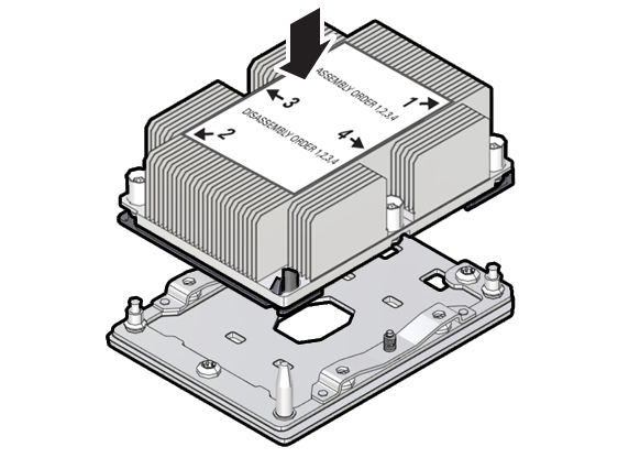

    5. Place the processor-heatsink module on the socket on the motherboard.
      The socket bolster plate has alignment pins that go into holes on the processor-heatsink module to help center the module during installation.
      image:Figure showing the processor-heatsink module being lowered                                     onto the socket.

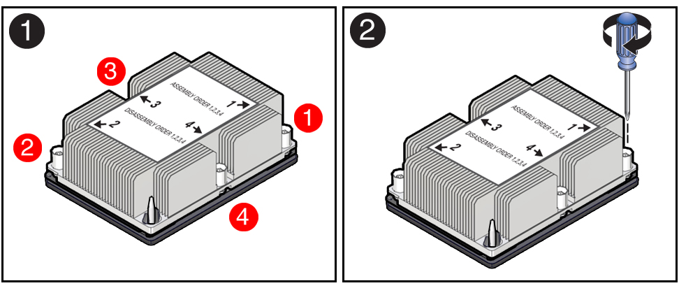

    6. Ensure that the processor-heatsink module lies evenly on the bolster plate and that the captive screws align with the threaded socket posts [1].
      image:Figure showing the heatsink captive screws being                                     tightened.
    7. Using a 12.0 in-lbs (inch-pounds) torque driver with a Torx T30 bit, tighten the processor-heatsink module to the socket. First, fully tighten captive nuts 1 and 2. Then fully tighten nuts 3 and 4 [2].
      As you tighten nuts 3 and 4, some resistance occurs as the bolster leaf spring rises and comes in contact with the heatsink.
      Caution
      Caution  -  Using an incorrect torque setting or driver bit can damage a processor-heatsink module.
