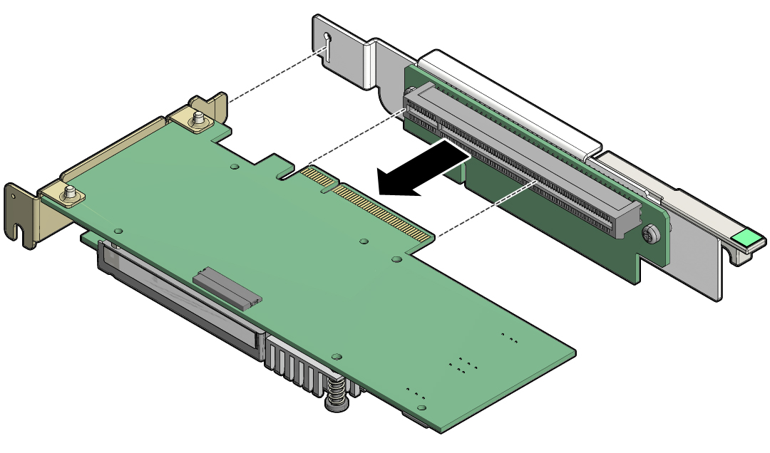

  2. Remove the PCIe card from the PCIe riser.
    1. Hold the riser in one hand and use your other hand to carefully pull the PCIe card connector out of the riser.
    2. Disconnect the rear bracket that is attached to the PCIe card from the rear of the PCIe riser.
    image:Figure showing how to remove a PCIe card from the riser in PCIe                             slots 1 and 2.
  3. Place the PCIe card on an antistatic mat.
