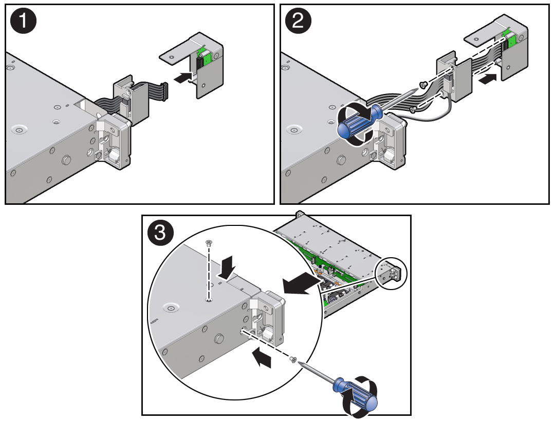

  3. If not installed, install the FIM cable through the plastic temperature sensor housing [1].
    image:Figure showing how to install the front indicator module (FIM) into                             the server.
  4. Connect the FIM cable to the replacement FIM assembly [1, 2].
  5. Using a Phillips screwdriver, tighten the two screws to secure the temperature sensor housing to the FIM assembly [2].
  6. Carefully insert the FIM assembly into the front panel of the server chassis [3].
  7. Install and tighten the two Phillips screws to secure the FIM assembly to the server chassis [3].
