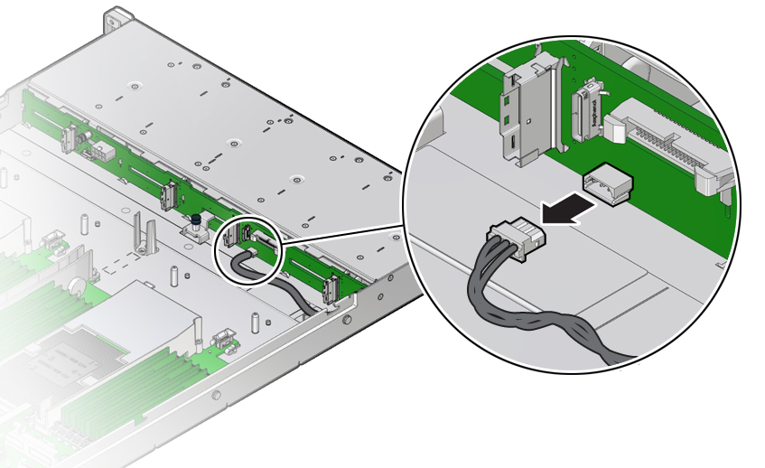

  2. Disconnect the temperature sensor cable from the disk backplane.
    image:Figure showing the temperature sensor cable being disconnected from                             the disk backplane.

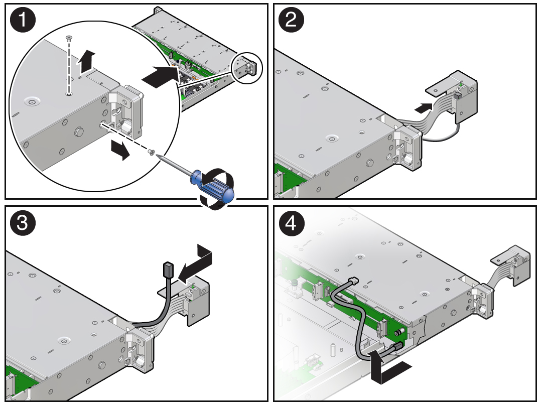

  3. Using a Phillips screwdriver, remove the two screws that secure the front indicator module (FIM) assembly to the server chassis [1].
    image:Figure showing the temperature sensor being removed from the                             chassis.
  4. Carefully slide the FIM assembly toward the front of the server to remove it from the chassis [2].
  5. Remove the temperature sensor from the plastic housing by pulling the sensor from its seated location. Then remove the sensor cable by pulling it through the slit in the housing [2, 3].
  6. Remove the temperature sensor and cable by carefully pulling the sensor cable rearward and through the left-front chassis sidewall. Then lift the temperature sensor from the chassis [4].
