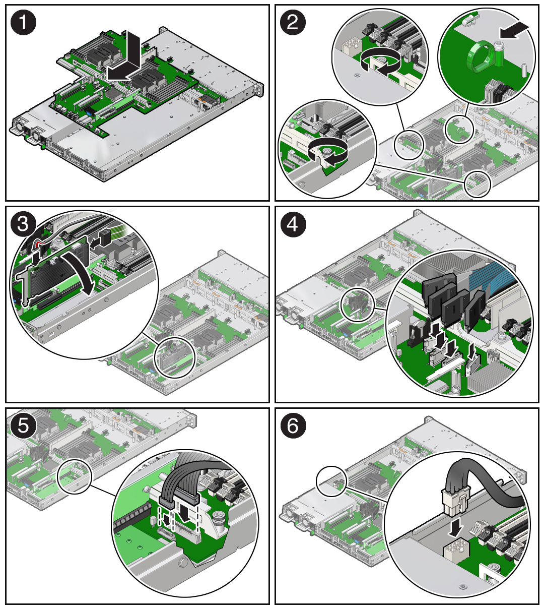

  2. Insert the motherboard into the server chassis [1, 2].
    1. Grasp the metal bracket located to the rear of the DIMMs and the finger grasp, and then tilt the front of the motherboard up slightly and push it into the opening in the rear of the server chassis.
    2. Lower the motherboard into the server chassis and slide it to the rear until it engages the eight mushroom-shaped standoffs located on the server chassis under the motherboard.
    3. Ensure that the indicators, controls, and connectors on the rear of the motherboard fit correctly into the rear of the server chassis.
      image:Figure showing how to installed the motherboard in to the                                     server.
    4. Using a Torx T25 screwdriver, tighten the two green captive screws to secure the motherboard bracket/handle to the server chassis [2].
  3. Reinstall cables on to the motherboard.
    1. Carefully reinstall the SAS cables and super capacitor cable along the left-side cable trough [3].
      See Install the Internal HBA Cables.
    2. Reconnect the front indicator module (FIM) cable to the motherboard connector [5].
    3. Reconnect the disk backplane data cable to the motherboard connector [5].
    4. Reconnect the disk backplane power cable to the motherboard connector [6]
