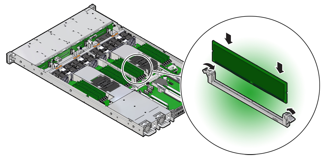

  3. Install a DIMM.
    1. Ensure that the ejector tabs are in the open position.
    2. Align the notch in the replacement DIMM with the connector key in the connector slot.
      The notch ensures that the DIMM is oriented correctly.
    3. Push the DIMM into the connector slot until the ejector tabs lock the DIMM in place.
      If the DIMM does not easily seat into the connector slot, verify that the notch in the DIMM is aligned with the connector key in the connector slot. If the notch is not aligned, damage to the DIMM might occur.
      image:Figure showing a memory DIMM being installed into the                                     sever.
  4. Repeat Step 3 until all replacement DIMMs are installed.
