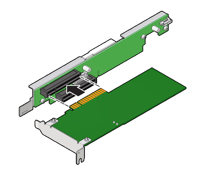

Install a PCIe Card in PCIe Slot 3
Retrieve the PCIe card and riser you want to install.
Locate the proper PCIe slot for the card you are replacing.
See
Illustrated Parts Breakdown
Insert the rear bracket that is attached to the PCIe card into the PCIe riser.
Hold the riser in one hand and use your other hand to carefully insert the PCIe card connector into the riser.
Install the PCIe riser.
See
Install the PCIe Riser Into PCIe Slots 3 and 4
