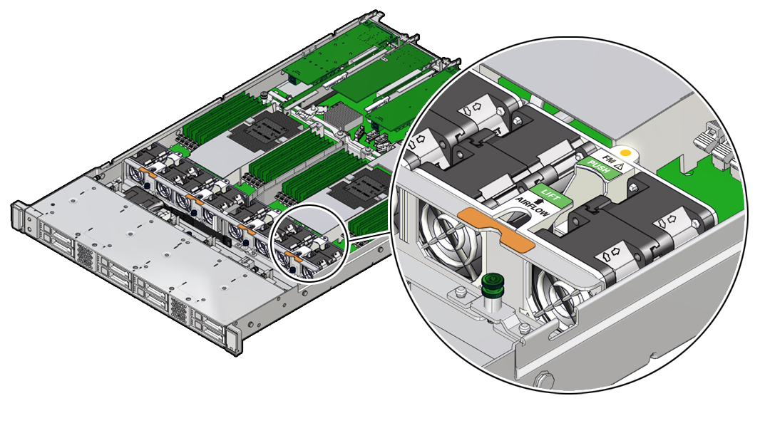

  3. Identify the faulty fan module.
    Each fan module has a fan status indicator (LED) that is located next to the module. If the LED is amber, the fan has failed. The location of the fan status LED is shown in the following figure.
    image:Figure showing the location of fan modules and associated status                             indicators.
    LED Color and State Meaning
    Amber – The fan module is faulty. The front Top Fan LED and the front and back panel Fault-Service Required LEDs are also lit if the system detects a fan module fault.
