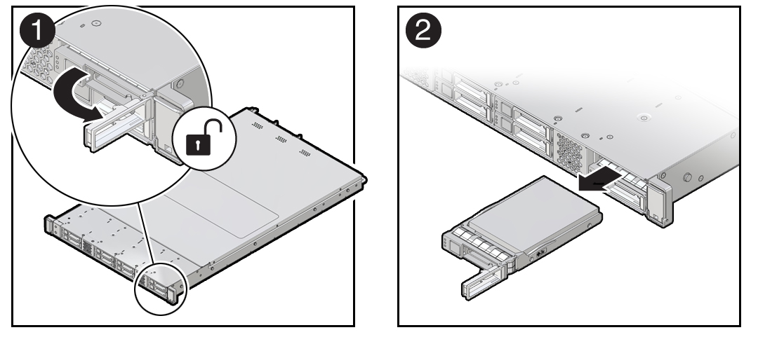

  4. Push the latch release button to open the drive latch [1].
    image:Figure showing the location of the hard drive release button                                 and latch.
    Caution
    Caution  -  The latch is not an ejector. Do not open the latch too far to the right. Doing so can damage the latch.
  5. Grasp the latch and pull the drive out of the drive slot [2].
