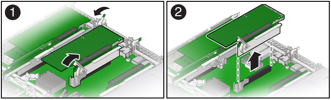

  4. Lift the green-tabbed latch on the rear of the server chassis next to the applicable PCIe slot to release the rear bracket on the PCIe card [1].
    image:Figure showing how to remove a PCIe riser from slots 1 and                             2.
    Note -  If the riser does not have a PCIe card installed, then lift the latch to release the PCIe slot filler panel.
  5. Lift the green-tabbed riser release lever on the PCIe riser with one hand and use your other hand to remove the riser from the motherboard connector [1, 2].
