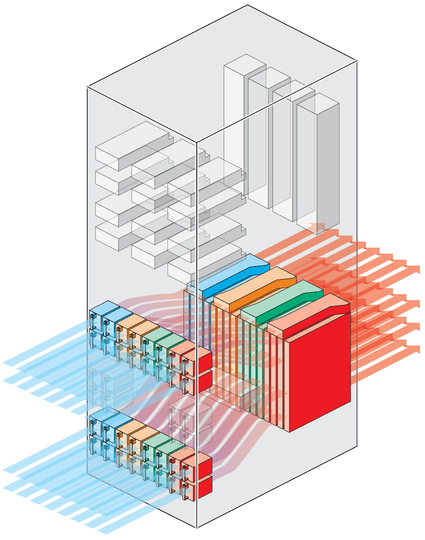

CoolingZone00, CoolingZone01, CoolingZone02, and CoolingZone03 cool the SPP and CMU slots. These zones are numbered from left to right, as viewed from the rear of the server.
Cooling for these four zones is supplied by the two fan cages, as shown below. Each fan module contains two fans. If a fan fails in a fan module, replace the entire fan module.
