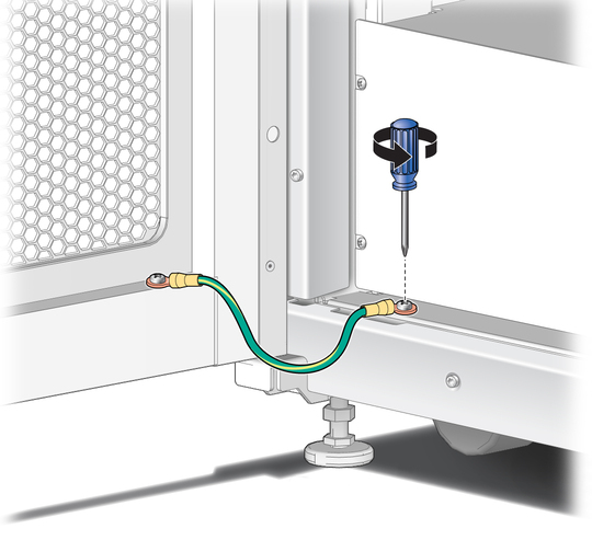

  1. Open the front door and use a T20 screwdriver to remove the M4 screw securing the ground cable connected to the server frame.
    Save the M4 screw in a safe location.

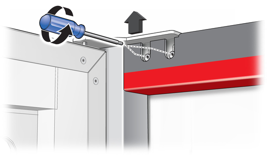

  2. Use a Torx T20 screwdriver to loosen the two M4 screws securing the upper hinge bracket to the server.
    Loosen, but do not remove these screws. Leave the upper hinge bracket loosely attached to the server.
    image:Figure shows how to loosen the upper door hinge screws.
