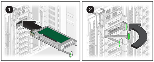

Note - The Sun Flash Accelerator F40 PCIe card is cold-service only. See Sun Flash Accelerator F40 PCIe Cards.
If the carrier slides correctly into the slot, you should feel a slight resistance as the carrier starts to seat in the connector.
![]() | Caution - Do not push the extraction lever while you insert the carrier into the slot. The carrier can enter at an angle and damage the connectors. |
The LEDs on the carrier and the card should remain off at this point.
Note - Refer to the Server Installation for instructions on managing and routing the I/O card cables.
The carrier's LEDs should blink for a few seconds until the PDomain enables the I/O card. The card's LEDs will show activity when the card is enabled.
