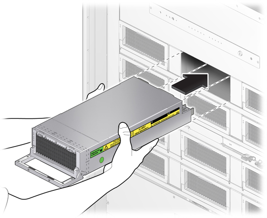

Note - The server will not boot unless all 12 power supplies are present.
The power supply should restart automatically.
