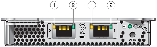

The two network ports on the EMS can operate at 10 Gb/sec, 1 Gb/sec, and 100BASE‐T speeds.
Each port has two LEDs. The LED on the left side of a port indicates the port's speed. See the following table. The LED on the right side of a port blinks green when active, and stays solid green when the port link is up but idle.
1SPARC M5-32 server only: LED 1 green luminance is low at 1 Gb/sec speed.
