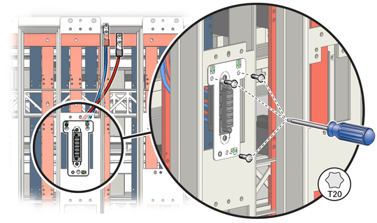

Remove three T20 Torx screws from the front of the bracket.

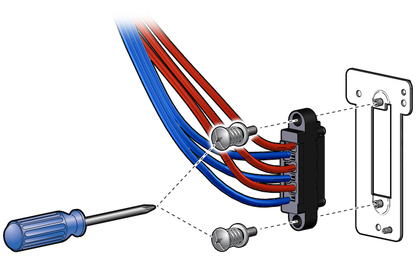

Remove the two Phillips No. 2 shoulder screws that hold the bracket to the cable connector. Each shoulder screw includes a spring and a washer.

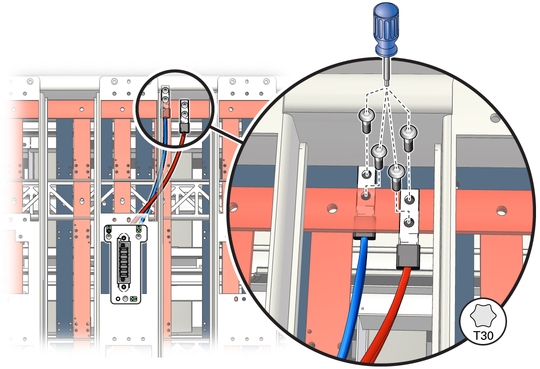

Remove two T30 screws from each terminal.
