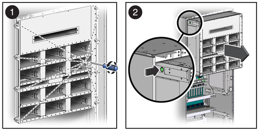

![]() | Caution - The empty power system cage weighs 207 lbs (94kg). At least two people and a mechanical lifting device are required for this procedure. |
Note - A lifting device is included with the replacement power system cage.
See Remove the Trim Panels to remove the following parts.
See Remove a PSDB.
![]() | Caution - Do not stack power supplies more than two units high. The EMI shields (the beryllium copper edge fingers) are easily bent or broken when another power supply or other heavy weight is placed on them. Offset the stacked power supplies so that the EMI shields do not interlock and break. |
See Disconnect AC Input Filters.
![]() | Caution - Failure to disconnect all of the AC input filters will result in damage to the power system cage. |
The locks on the sides of the power system cage will stop the cage before it is completely out of the cabinet.
