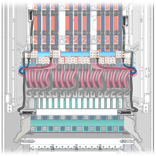

![]() | Caution - Use an antistatic mat to protect the cable. |
Note - For access to the cable, the server must be powered down so that the components shown below can be removed.
See Remove the Door.
See Remove the Trim Panels to remove the following parts.
The figure below shows cable brackets on the right side of the cabinet. The cable brackets on the left side of the cabinet are removed in the same way.
Note - There are two scalability midplane to PSDB cables, one on the left side of the server and one on the right. The left and right cables are identical.
Note - Take care not to drop the screws. These are not captive screws.
