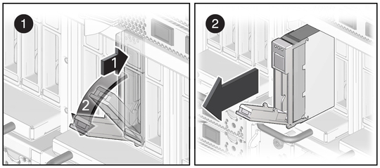

Confirm that the HDD slot label shows the correct slot number (HDD n). The label is just above the HDD on the server chassis.
Note - SPARC M5-32 server only: The green LED on the drive remains lit at all times. If the drive has been properly unconfigured it can be removed even though the green LED is lit.
See Prepare an HDD for Removal for instructions on unconfiguring the HDD and verifying its status.
The extraction lever under the release button swings partially open.
![]() | Caution - The latch is not an ejector. Do not force the latch down. Doing so can damage the latch. |
Note - Do not leave a slot empty. The server might overheat.
