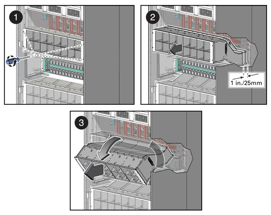

Remove the Scalability Card Cage

The empty cage weighs 35 lb (16 kg).
See detail 1 below.
Note - The scalability card cage has been omitted from the illustration for clarity. Do not remove the scalability card cage.
