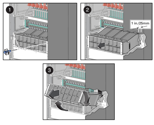

The empty cage weighs 39 lb (18 kg).
See detail 1 below.
Note - The scalability card cage has been omitted from the illustration for clarity. Do not remove the scalability card cage.
See detail 2 above.
Tilt the fan cage down at an angle of approximately 15 degrees so that the rear of the fan cage can bypass the bottom of the scalability card cage.
See detail 3 above.
