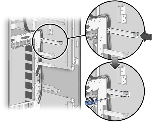

Tighten the screws to 15 in-lb. See Torque Reference.
See the following illustration.
The figure below shows cable brackets on the right side of the cabinet. The cable brackets on the left side of the cabinet are installed in the same way.
