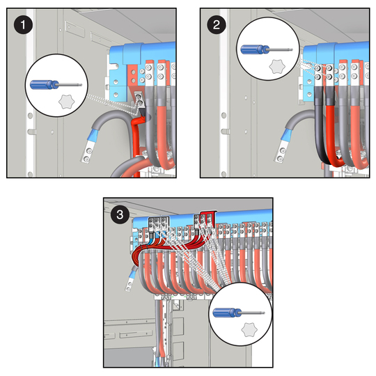

Tighten the T20 Torx screws to 15 in-lb. See Torque Reference.
The black negative cable is on the left, with the red positive cable on the right.
Tighten the screws to 7 in-lb.
