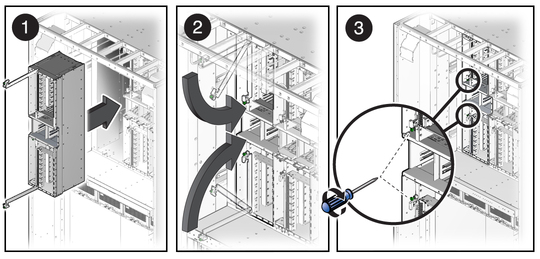

Install an I/O Data Cable
Caution
Caution - Do not remove the protective plastic covers from the connectors on the cable until you are ready to plug a cable connector into a socket. Unprotected connectors can be damaged as you push them through the mass of other cables in the server.
Caution
Caution - Avoid excessive bending of the cable. Repeated bending of the cable can break wiring to individual connector pins.

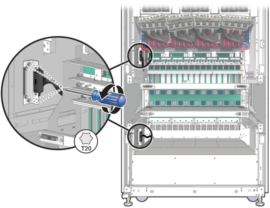

  1. Use an antistatic wrist strap to protect the equipment from ESD damage.
  2. Install the T5 connector:
    1. Remove the plastic cover from the connector.
      Do not discard the plastic cover. The covers will be returned to Oracle.
    2. Plug the T5 connector into the socket on the midplane.
      image:Installing the T5 data cable.
    3. Tighten the captive T20 Torx screw.
      Tighten the screw to 15 in-lb. See Torque Reference.

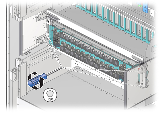

  3. Install the T6/T7/T8/T9 connector assembly:
    1. Remove the plastic cover(s) from the assembly.
      Do not discard the plastic cover(s). The covers will be returned to Oracle.
    2. Insert the cable assembly into the socket on the midplane.
    3. Raise the hinged metal bars on the cable assembly and press them forward until the ends lock into the plastic tabs on the connector of the power cable assembly.

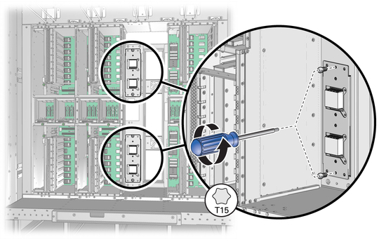

  4. At the rear of the server, install the T1/T2 and T3/T4 cable assemblies:

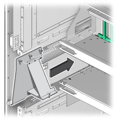

    2. Insert the T1/T2 cable assembly through the lower opening in the support bracket.
      Carefully push the assembly from the rear of the bracket.
    3. Use four T20 Torx screws to attach the T1/T2 assembly to the support bracket.
      Before tightening the screws, verify that you have used the correct location on the bracket. The T1/T2 go into the lower position. T3/T4 go into the upper location.
      Tighten the screws to 15 in-lb.
      image:Unlocking the data cable.
    4. Use four T20 Torx screws to attach the T3/T4 assembly to the upper opening on the support bracket.
