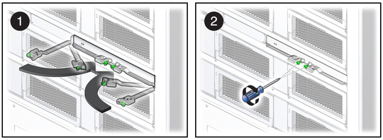

Tighten the screws to 15 in-lb. See Torque Reference.
See Restart the Server.
