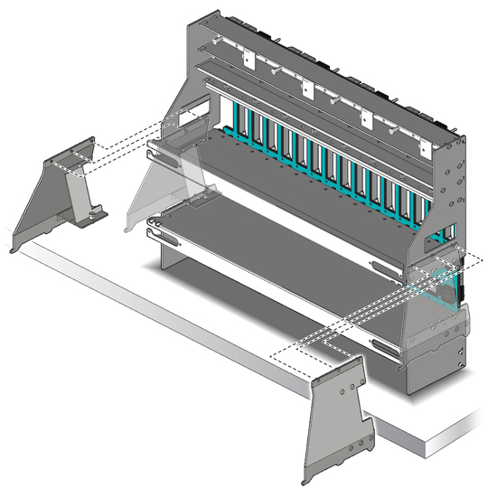

    3. Attach the handles to the sides of the midplane.
      1. Insert the keyed pins on the handles into the keyholes on the sides of the midplane.
        image:Drawing shows attaching handles to the midplane.
      2. Raise the spring-loaded lock pin, and then align the pin with the corresponding hole in the base of the midplane.
      3. Install the second handle in the same manner.

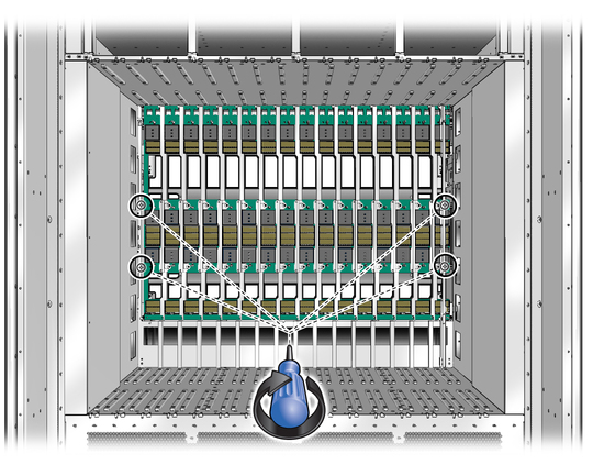

    3. At the rear of the server, install and tighten four T20 Torx screws through the CMU cage to the rear of the midplane.
      Use the torque screwdriver that is included with the replacement midplane. Set the torque screwdriver to 15 in-lb.
      image:Figure shows screws in CMU cage.

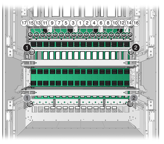

    4. Return to the front of the server and tighten the front midplane screws.
      1. Follow the numbered sequence shown in the illustration to tighten the top row of screws.
        Start in the middle of the top row, and then alternate right and left until all screws are tightened.
        Use the torque screwdriver to tighten the screws to 15 in-lb.
        The 13-screw midplane has nine screws in the top row.
        image:Figure shows the order for tightening the front screws on the 13-screw midplane.

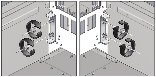

    5. Adjust two support brackets inside the cabinet.
      Note - This step applies only to cabinets with the 21-screw midplane. Cabinets with the 13-screw midplane do not have support brackets.
      1. Raise the brackets to press against the bottom of the midplane.
      2. Tighten the 10‐mm M6 nuts to approximately 15 in-lb (1.7 Nm).

    6. Remove the handles from the sides of the midplane.
      1. Raise the spring-loaded lock pin on a handle.
      2. Raise the handle slightly to free the keyed pins at the fop from the keyholes on the midplane.
      3. Tilt the handle to remove the hooked tab from the slot in the slide, and then set the handle aside.
      4. Repeat Step i through Step iii to remove the second handle.
