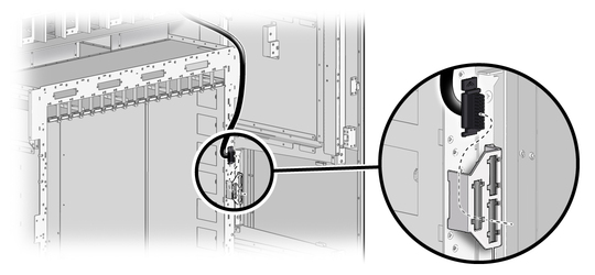

The connector plugs into the bracket without screws.
If necessary, disconnect the bracket from the chassis. Two T20 Torx screws hold the bracket to the chassis. This bracket holds three cable connectors. To install the bracket, tighten the screws to 15 in-lb. See Torque Reference.

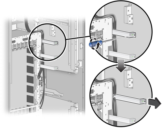

The cable is included in a group of cables that are routed up the side of the server. Three long brackets hold the cables in place.
The figure below shows cable brackets on the right side of the cabinet. The cable brackets on the left side of the cabinet are removed in the same way.
