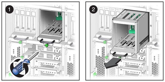

If the hard drive cage is in a SPARC M5-32 or early SPARC M6-32 server, see EMS and Hard Drive Cage Compatibility . Be certain that you have the correct replacement.
See Prepare to Power Off the Server.
![]() | Caution - Danger of electrocution: AC circuits in the server share current. Remove all sources of AC current from the server. |
Note the order of the hard drives. They must be installed in the same order in the replacement cage.
