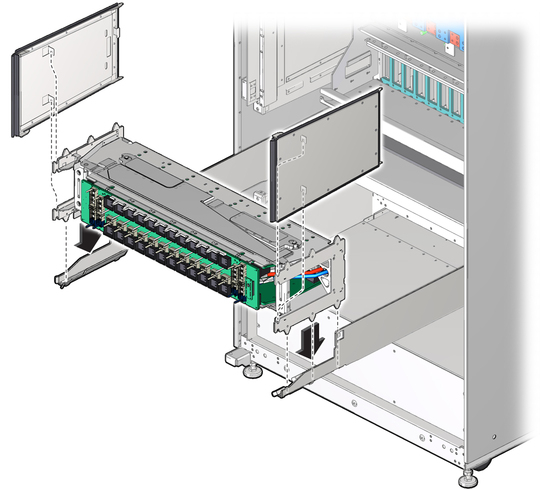

Note that the tabs on the sides of the panels must face down. The two panels are not interchangeable.

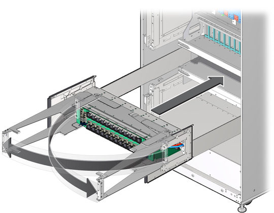

![]() | Caution - Push both handles simultaneously. This action keeps the scalability assembly parallel to the midplane. Pushing just one handle forces the scalability assembly at an angle to the midplane and damages the connectors. |
When the scalability assembly reaches the end of the slot, the extraction handles start to close as they engage the midplane.
![]() | Caution - There is very little clearance to the sides. Be very careful sliding the scalability assembly between the cables on the sides of the cabinet. |
![]() | Caution - Because of the weight of the scalability assembly, it is easy to accidentally damage the connectors at the rear. Push the scalability assembly slowly until the connectors on the scalability assembly and midplane are engaged. |
Push both handles slowly and simultaneously to lock the scalability assembly.

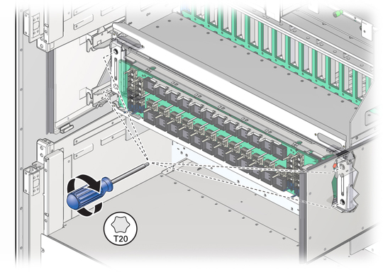

Use a socket extension if necessary.
Tighten the screws to 15 in-lb. See Torque Reference.
