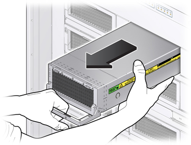

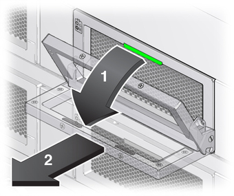

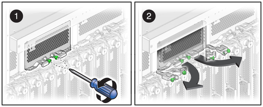

  5. Remove the faulty power supply from the server:
    1. Push the green release button up into the handle.
      image:Figure shows how to unlock a power supply.
    2. Pull the handle down into the horizontal position.
    3. Pull the power supply part way out of the slot.
      A safety lock on the side will stop the power supply.
      Note - A label on the side of the power supply indicates how near the end of the power supply is to the front of the opening.
    4. Press the green release button on the right side of the power supply to unlock it.
      image:Figure shows how to release a power supply.

      Caution - Do not allow the back of the power supply to drop. The connectors at the rear of the power supply will be damaged.
    5. Support the bottom of the power supply as you pull it completely out of the slot.
      image:Figure shows how to avoid dropping a power supply.
    6. Inspect the connectors inside the empty slot for possible damage.
    7. Place the power supply on an antistatic mat.
