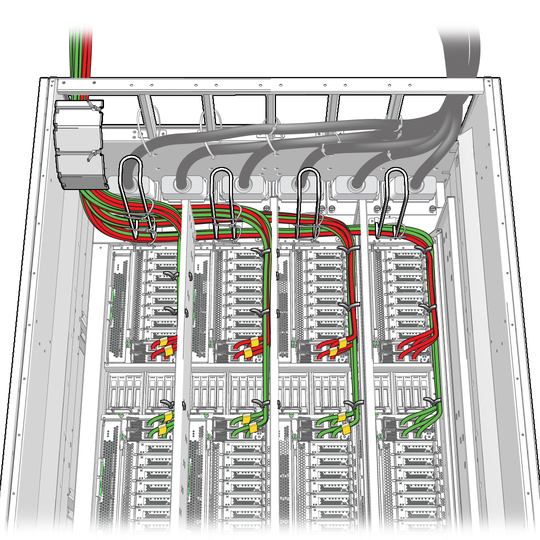

Label the cables with their IOU numbers and slot numbers to avoid confusion during the installation steps.
