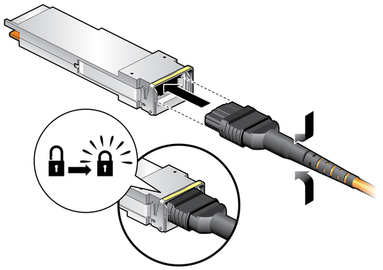

If you are to assemble an Infiniband cable or Ethernet pass-through cable, you will need two QSFP optical transceivers and a fiber optic cable.

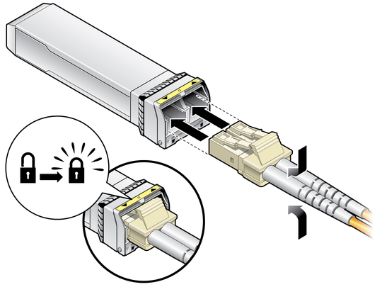

If you are to assemble an Ethernet splitter cable, you will need one QSFP optical transceiver, four SFP+ optical transceivers, and an optical splitter cable.
Note - The MTP connector and QSFP receptacle are keyed for proper fitting.
Note - The LC connector and SFP+ receptacles are keyed for proper fitting.
