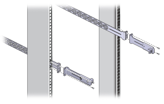

The open end of the tab is toward the flange. The flat end of the tab is toward the rear of the extender.

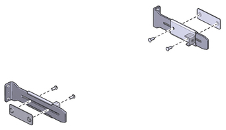

The flange of the long front brackets point away from the gateway.
The edge of the C-shaped bracket is flush to the rear of the chassis.

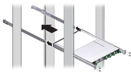

Ensure that there is 24 inches (610 mm) of power cord slack at the front of the rack to provide an adequate service loop when removing the gateway from the rack.

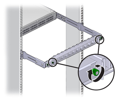

Ensure that the ends of the long rails slide into the C-shaped brackets at the rear of the gateway chassis and that the power cords lay into the cut-outs of the long front mounting brackets.

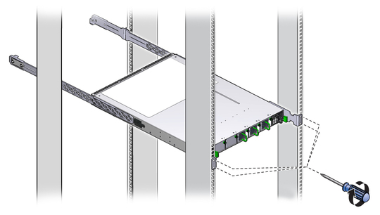

Tighten the screws securely.
