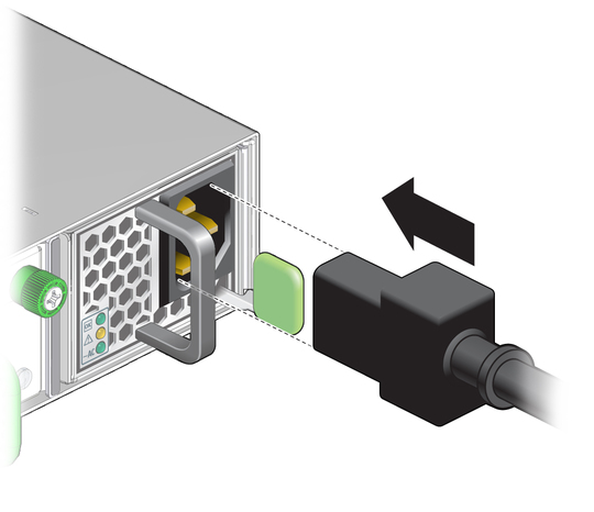

The AC LED lights green to indicate that the power supply is connected to facility power. A moment later, the OK LED lights green to indicate the power supply is at full power.
For example, to check the power supplies:
FabMan@gateway_name->checkpower PSU 0 present status: OK PSU 1 present status: OK All PSUs OK FabMan@gateway_name->
FabMan@gateway_name->checkvoltages Voltage ECB OK Measured 3.3V Main = 3.30 V Measured 3.3V Standby = 3.42 V Measured 12V = 12.06 V Measured 5V = 5.03 V Measured VBAT = 3.17 V Measured 1.0V = 1.01 V Measured I4 1.2V = 1.22 V Measured 2.5V = 2.51 V Measured V1P2 DIG = 1.18 V Measured V1P2 ANG = 1.18 V Measured 1.2V BridgeX = 1.22 V Measured 1.8V = 1.80 V Measured 1.2V Standby = 1.20 V All voltages OK FabMan@gateway_name->
Gateway Reference, checkpower command
Gateway Reference, checkvoltages command
