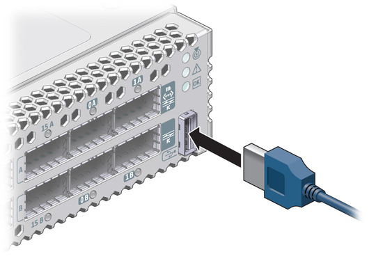

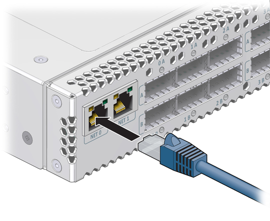

The gateway has two connectors for network or serial communication with the management controller.
The network management connector, labeled NET, is a 100/1000 BASE-T Ethernet interface. This connector is preferred because it permits remote management of the gateway over the Ethernet network.
The USB management connector, labeled with the USB symbol, is the second choice for communication with the management controller in the gateway. The management console can be a serial terminal, a system running a TIP connection, or other serial device that communicates with the management controller through a USB-to-serial adapter. The serial parameters for communication with the USB-to-serial adapter is typically 115600, 8, N, 1.
Connections to the management controller are made through DHCP.
The MAC address is printed on the customer information (yellow) sheet on the outside of the gateway shipping carton and on the pull-out tab on the left side front of the gateway chassis, adjacent to power supply 0.
Note - If a DHCP server is not available, the management controller has a default static IP address of 169.254.0.36 with a subnet mask of 255.255.0.0. Alternatively, you can connect a USB-to-serial adapter cable between the gateway's USB port and a terminal device. This connection provides alternative communication with the management controller. The terminal device must be configured for 115200 baud, 8 bit, no parity, 1 stop bit.
