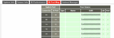

This figure provides an example of the IB Port Map tab.
The IB Port Map tab displays information about peer devices attached to the gateway. A table describes this information:
Connector – Rear panel connector respective to the I4 switch chip port
I4 Port – Port of the I4 switch chip
Type – Type of peer device attached to the connector or I4 switch chip port
Name – Contents of the peer device's NodeDescription field
GUID – GUID of the peer device
LID – LID assigned to the peer device
Port – Port of the node identified by the GUID or LID
Note - You must select the Poll I4 checkbox (default) in the control panel to populate the table with current information.
By clicking on a column heading, the information in the table is sorted according to that column heading, either in ascending or descending order. For example, clicking the Connector heading sorts the information in the table according to the numeric sequence of the connectors. Clicking the peer device Name heading sorts the information in the table according to the NodeDescription field of the peer device.
