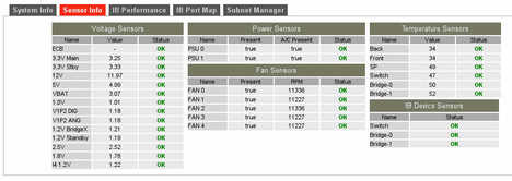

This figure provides an example of the Sensor Info tab.
The Sensor Info tab displays status information regarding the gateway sensors. The information is categorized in these groups:
Voltage Sensors – Assorted voltages on the main board
Power Sensors – Presence, AC presence, and status for both power supply slots
Fan Sensors – Presence, RPM, and status for each fan slot
Temperature Sensors – Back, front, management controller, I4 switch chip, and BridgeX chips
IB Device Sensors – I4 switch chip and BridgeX chips status
