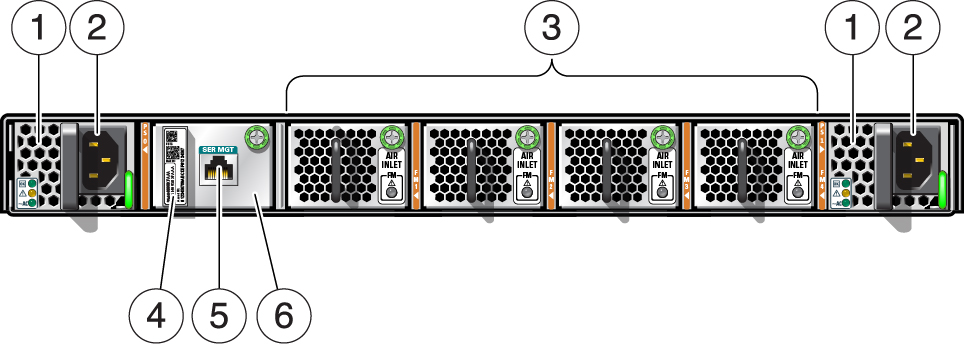

Front Panel Components
Item
Description
Links
1
Power supplies
Servicing Power Supplies
2
Power cord receptacles
Power Off a Power Supply
Power On a Power Supply
3
Fan modules
Servicing Fan Modules
4
RFID tag
Read the Switch Serial Number (Oracle ILOM)
Remove the Air Duct Assembly
5
SER MGT port
Access the SP (SER MGT Port)
6
SMM, with battery inside
Servicing the Battery
