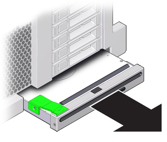

  2. At the front of the server, push down on the latch on the top left corner of the DVD drive or filler panel.
    image:An illustration showing the action described in this text.
  3. Slide the DVD drive or filler panel out of the server.
    Caution
    Caution  -  Whenever you remove the DVD drive or filler panel, you should replace it with another DVD drive or a filler panel; otherwise the server might overheat due to improper airflow.
