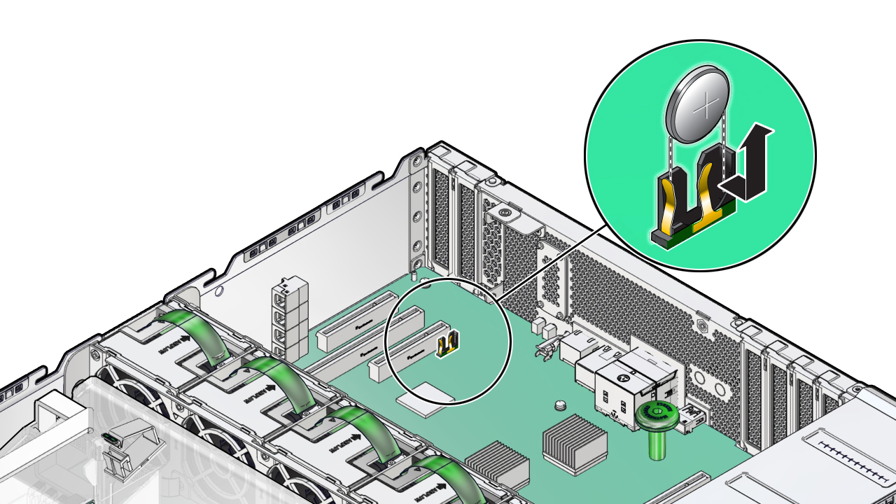

Remove the Battery
Removing the battery is a cold-service operation. You must power off the server before you remove the battery.
  1. Back up the Oracle ILOM variables.
    See http://docs.oracle.com/cd/E19860-01/E21549/z40015841018582.html#scrolltoc
  2. Prepare for service.
    See Preparing for Service.
  3. Lift the battery out of the receptacle.
    image:The illustration shows removing the battery.
  4. Set the battery aside.
  5. Consider your next step.
