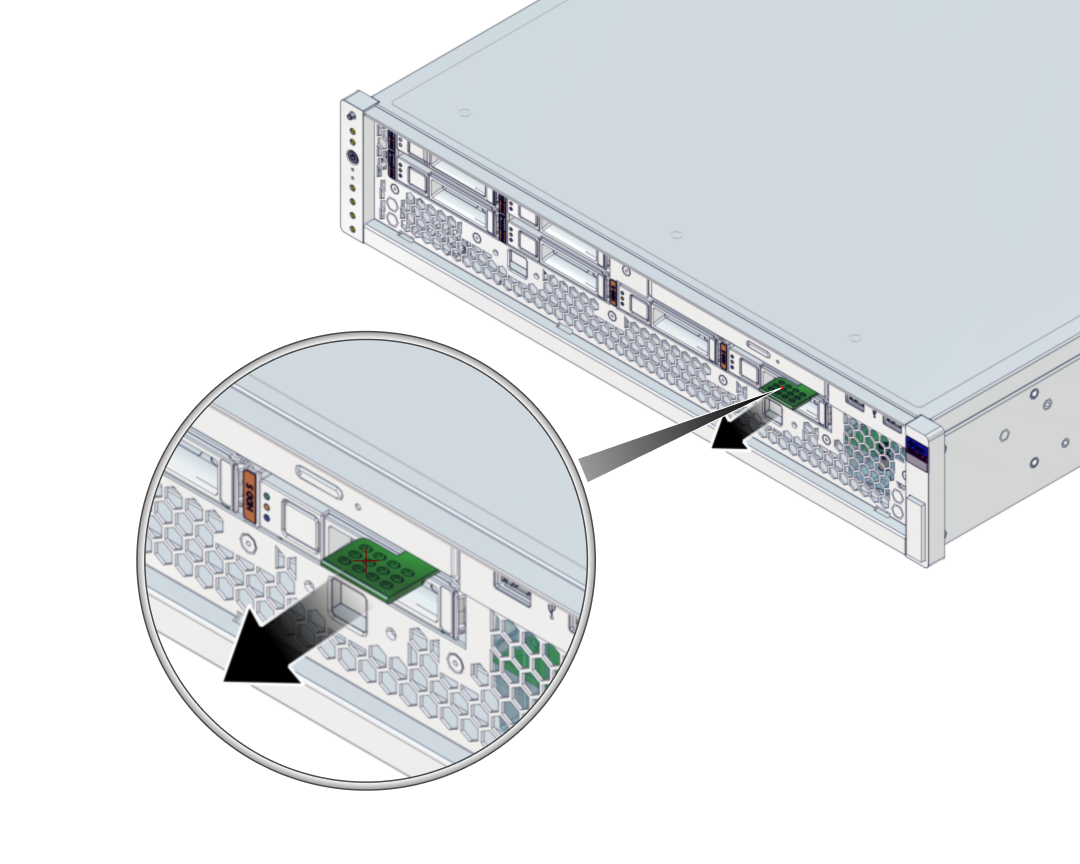

  6. Pull the plunger on the DVD component, then remove the DVD component.
    image:Figure showing DVD plunger for removing the DVD component.

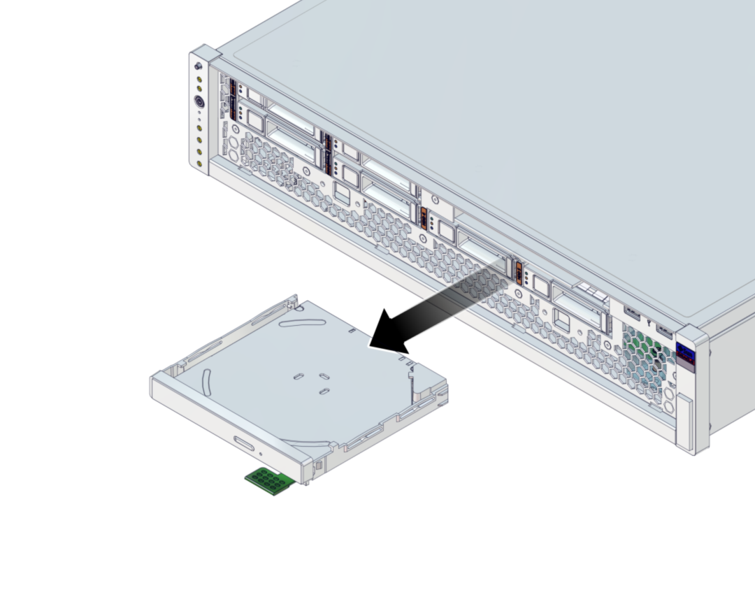

  7. Continue to pull the tab, so that the DVD drive slides out of the server.
    image:Figure showing tab to remove the DVD.
  8. Set the DVD drive aside.
