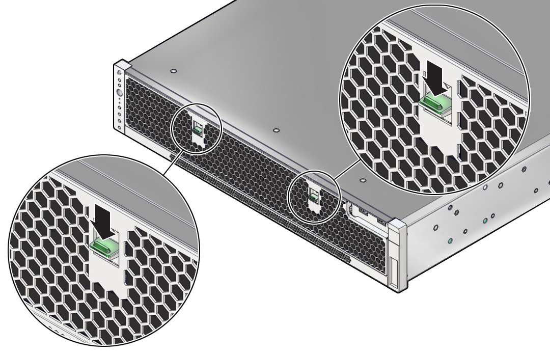

  2. Press down on the two release latches.

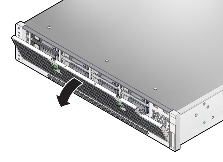

  3. Tilt and pivot the air filter away from the server.
    image:The illustration shows removing the air filter.
  4. Lift the air filter from the server.
