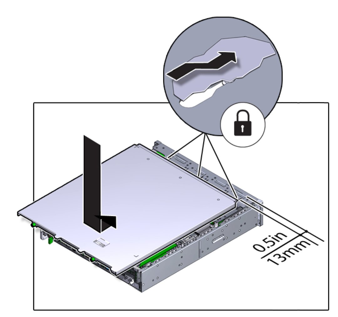

Position the top cover on the chassis, with the front edge of the top cover
0.5 in. (13 mm) rearward of the front edge of the chassis.
Slide the top cover forward into place.
Secure the top cover with the two captive screws at the rear.
