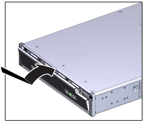

  2. Set the bottom edge of the filter into the lip at the front of the chassis.
    image:The illustration shows installing the filter.
    The left and right release levers are facing forward.
  3. Pivot the filter to vertical.
    The release levers snap the filter into place.
